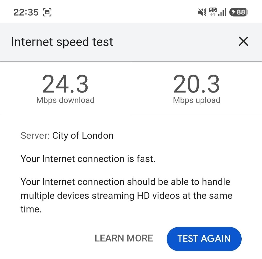

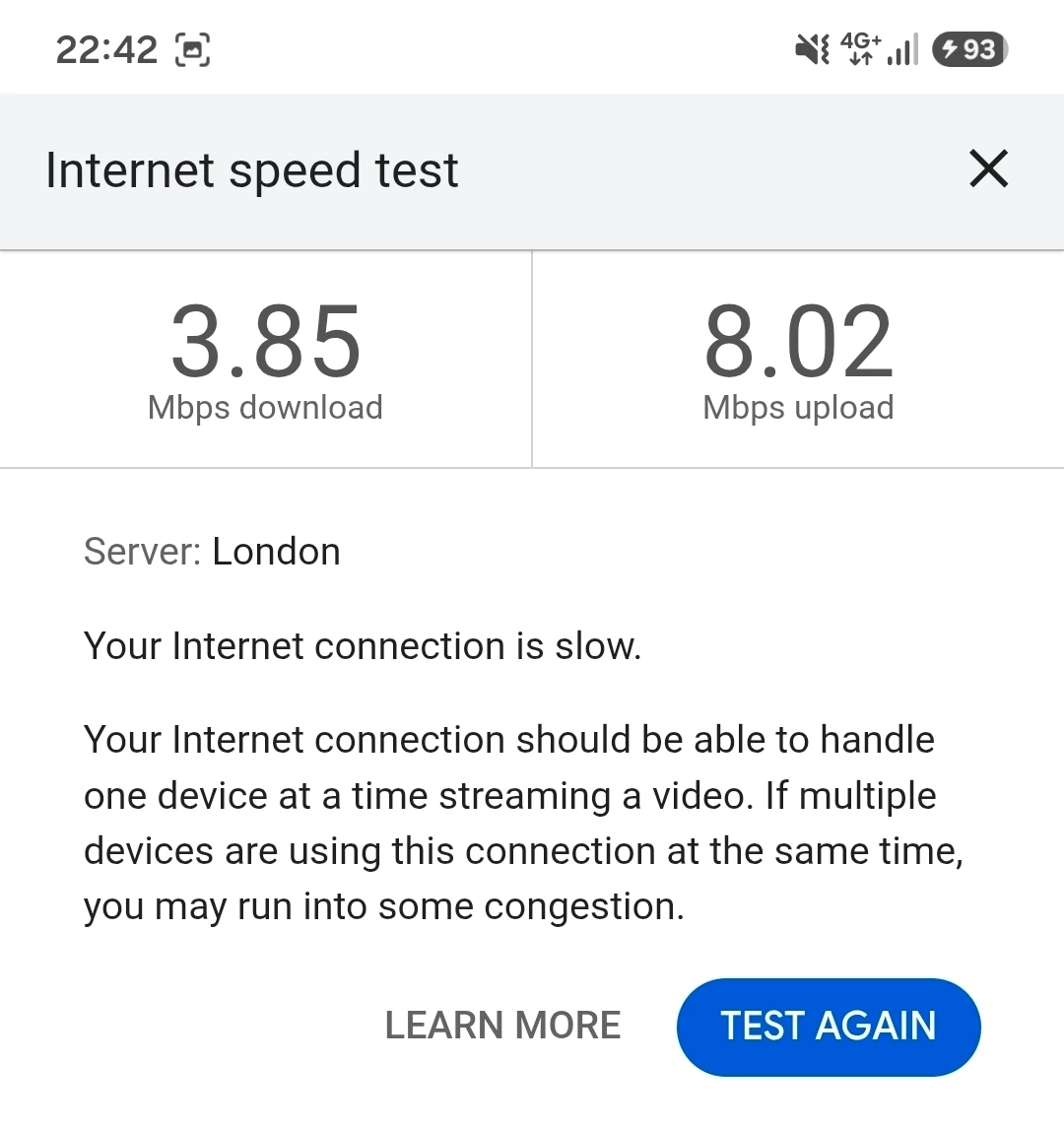

Hi, I am a heavy data user with an unlimited Sim. In the last month I have used 147GB. Tonight my speeds have dropped from a reasonable 4g/5g speed to around 5mbps. I have tested this with numerous devices, checked the coverage checker and service status. Everything appears normal and nothing is showing as having any issues. I am under the impression that ID did not throttle speed after a certain data usage after a reply by an employee here -
