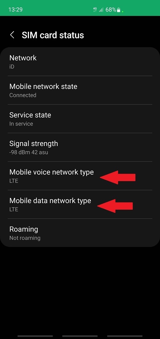

1st call over LTE in a non 3G area, so yep nowt wrong here, but note the signal strength

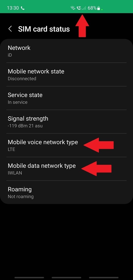

2nd call using WiFi calling, exact same location but again note the drop in network signal

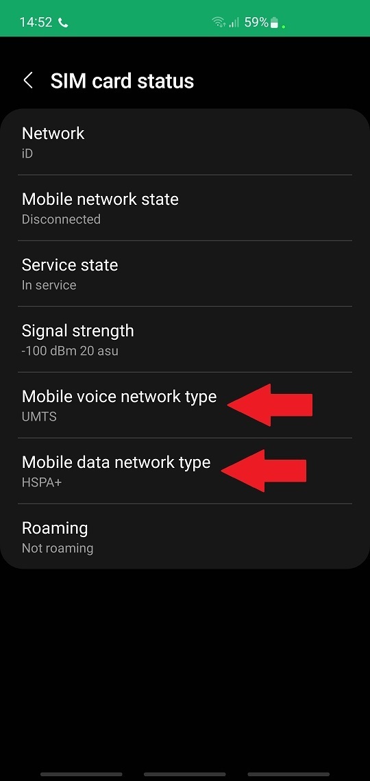

3rd call, about 3 metres away from previous calls, WiFi calling on but deliberately just on the range limit of the WiFi and my phone is using 3G (note UMTS and HSPA+) and the signal strength
So if Three are being truthful and 3G has been switched off, and they’re not hitting the panic button and thus switching 3G back on and off (this 3G calling malarkey has been going on since they switched off 3G here) then I have no answer as to why my phone keeps making 3G calls, when it shouldn’t be possible.

Okay ​@Daz_S, scenario 3 appears to have contradictions.
Mobile network state
Disconnected
This doesn’t seem compatible with either of the following:
Mobile voice network type
UTMS
Mobile data network type
HSPA+
Perhaps the latter 2 indicate a network connection for emergency calls, given lack of radio signal on your home network - just a thought.

Just to clarify - Ignoring all my above images - I normally have, SINCE 3G off here, my phone as per:
  • WiFi connection on
  • WiFi calling toggled off
  • Mobile data enabled but when my phone is on WiFi → via About phone → SIM status → it shows mobile network state Disconnected (note mobile data v mobile state)
Or
  • WiFi off (or out of range)
  • WiFi calling enabled or disabled as it makes no difference as no WiFi
  • Mobile data enabled → about → status → mobile network state Connected
The above is to be expected.
WiFi on and mobile network state shows as disconnected as using WiFi for data traffic.
WiFi off and mobile network state shows as connected, thus using mobile data for data traffic.
Mobile voice network type - this used to be UMTS before 3G got pulled. Now I only (should) have 4G, thus 4G or LTE required to use VoLTE  (as you know).
LTE and VoLTE obvs enabled.
After 3G off my phone often shows as LTE for both voice network and data network. This at random changes to UMTS and HSPA+, or also occasionally stays as LTE until you make or receive a call. The latter I believe is due to such a weak 4G signal and is dropping to an impossible 3G. It’s as if Three keep turning 3G back on!
I assumed emergency calls still reverted to 2G, though I could be wrong. I know 2G is not showing on Three’s coverage but recently been using rival providers service status pages. Voda still have 2G enabled. I probably wrongly assumed my iD SIM would jump to Voda’s 2G for emergency calls….?
Just curious - what other networks have coverage at your location?
I can have any of the big 4, just the signal strength for EE, O2 and Three* are problem
*A delivery guy did drop a parcel off and we got chatting. He has an eSIM on Three and his signal wasn’t much better than mine. So kinda think this isn’t a good ship to jump to either.
You may recall, I was on Tesco and my Son moved from them to O2 - he had a better signal, we swapped cards and the problem moved, thus (crudely) putting the blame on a weaker Tesco signal.
EE, O2 and iD do not give me full signal here. Haven’t as yet tried Vodaphone since 3G off. I’ve not personally gone direct to Three as yet either, more so based on others saying its bad around here.
But I can replicate the above in other areas close by and can match exactly with another phone on iD too. All I know is this signal issue really does my head in!

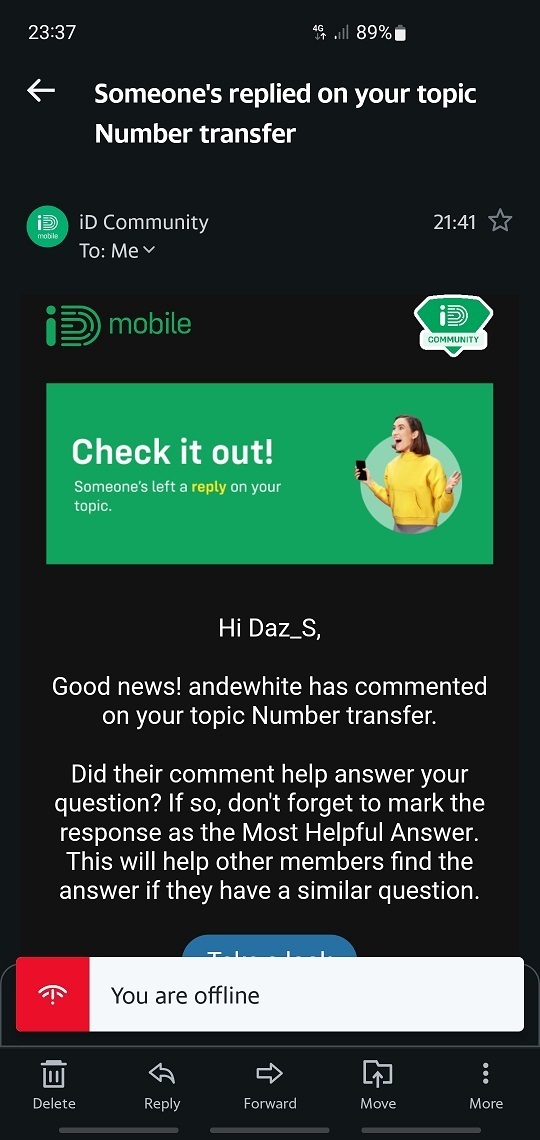

Probably a final post on this thread. But will get round to adding to my ongoing saga on my thread at some point
Just to show the 4G data side of things doesn’t just drop calls!!!
I literally watched the signal drop away just as I went to open a form email notification.
