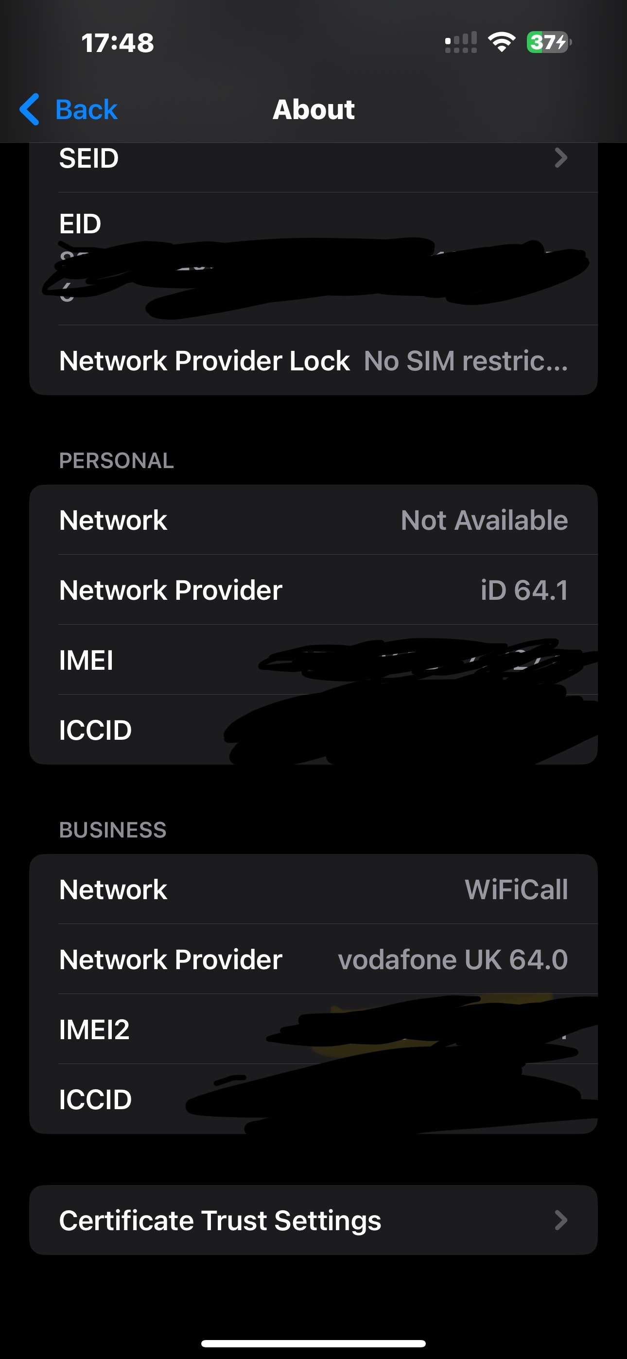

Hi,
I live in an area with no signal most of the time. I have had no functionality of WiFi calling since yesterday morning on my ID Mobile number (physical sim) .worked perfectly before.
i have an e sim on Vodafone on same phone with WiFi calling working perfectly on that in same WiFi network.
i have an IPhone 15 Pro Max with the latest software.
i have contacted the broadband provider and apple support at length with everything seeming fine.
I have toggled Wi-Fi calling on and off multiple times. I have reset network settings multiple times. I’ve turned off the phone multiple times I’ve used aeroplane mode only.And it works perfectly with the Vodafone Sim but the ID sim when on aeroplane mode comes up with an error message saying please connect to Wi-Fi.
i have been to curry’s and got a new physical sim and installed it and still not working.
Seems like ID network is not recognising that I am connected to a Wi-Fi network.
I have obviously talked to ID customer Support over chats multiple times and they have Said that it is either the Wi-Fi companies’s problem or Apple’s problem. It is neither , given another sim works perfectly on same device and WiFi network
i am at a complete loss , really need this to work as I run a business and cannot receive or make calls at home . I will have to leave ID unless they can fix this.
Is there anyone out there that can help?
thanks!

Are you using iOS 18.5 with Network Provider “Three 64.1” or “iD 64.1”, ​@Tom01914
Seems Three and their MVNO carriers have added a new setting (very recently), which seems to have broken the WiFi Calling service on the Three mobile network.
I have iPhones that have worked perfectly with WiFi Calling for a long time. Now after updating to iOS 18.5 and accepting the carrier update, WiFi Calling doesn’t work with my SMARTY and Three PAYG SIM cards.
However, using the same iPhone devices with a giffgaff SIM card WiFi Calling works perfectly - the giffgaff Network Provider is “giffgaff 64.0”, which seems to be the initial version for iOS 18.5 update.
Also seen seem similar issues reported in the EE community.

Thanks all very helpful! Please see below info
Network
Network Provider
IMEI
ICCID
Not Available
iD 64.1
Forum|alt.badge.img
  • June 9, 2025
Yes you’re right . 64.0 works. 64.1 doesn’t work

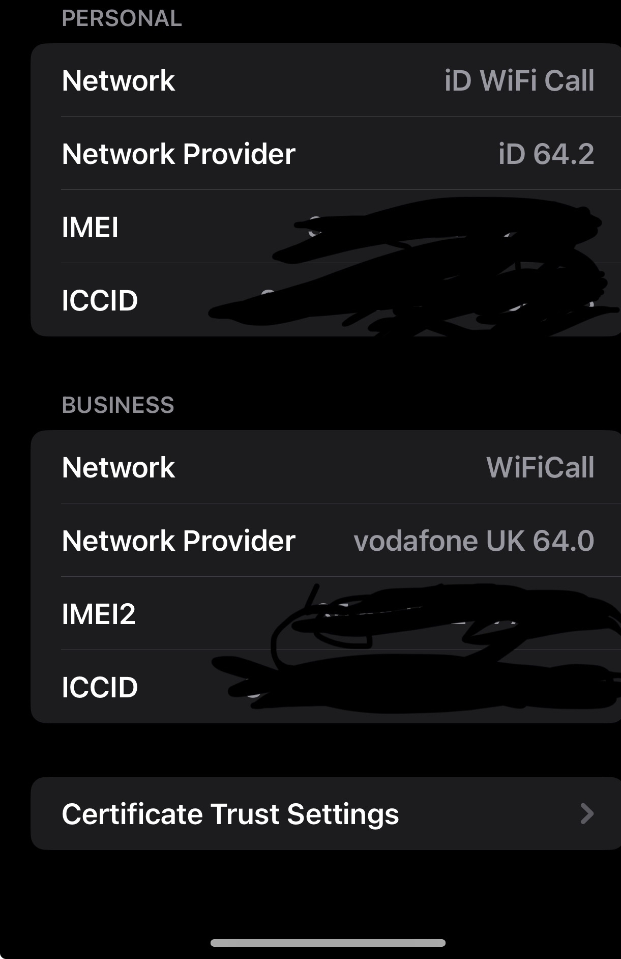

  • June 10, 2025
Just a little update . I read on a three mobile forum from someone having a similar problem that they had released 64.2 carrier update . And sure enough they have, I’ve updated to it and now my Wi-Fi calling is working on ID mobile again! It does not work when aeroplane mode is activated like My Vodafone Sim dows which I don’t understand why but nonetheless this is fine for me!
Thanks for your help guys!

  • June 10, 2025
I went back into ‘about ‘ section and scrolled down to network and it had another update . I updated once again manually and now ID works with WIFI calling in aeroplane mode! 👌

Forum|alt.badge.img
  • June 10, 2025
Still 64.2
