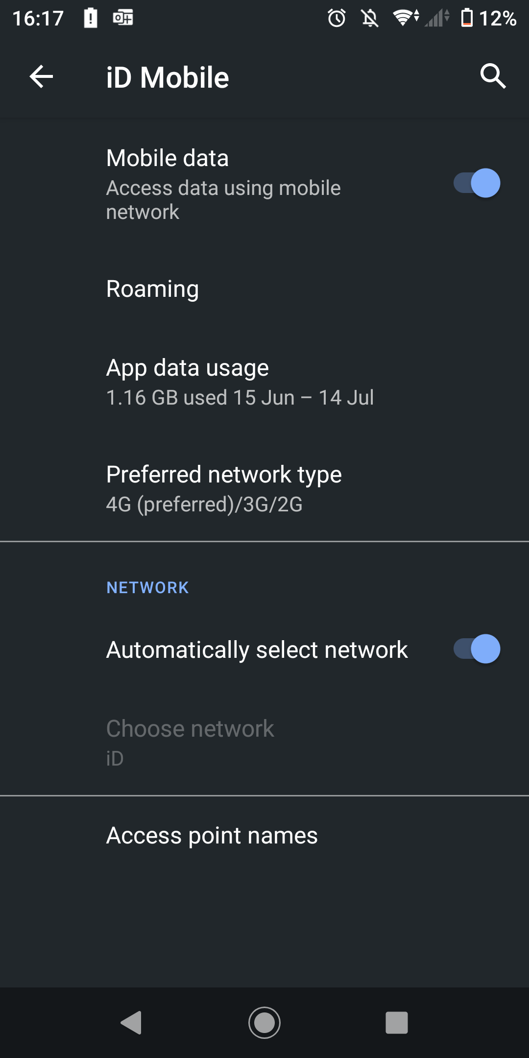

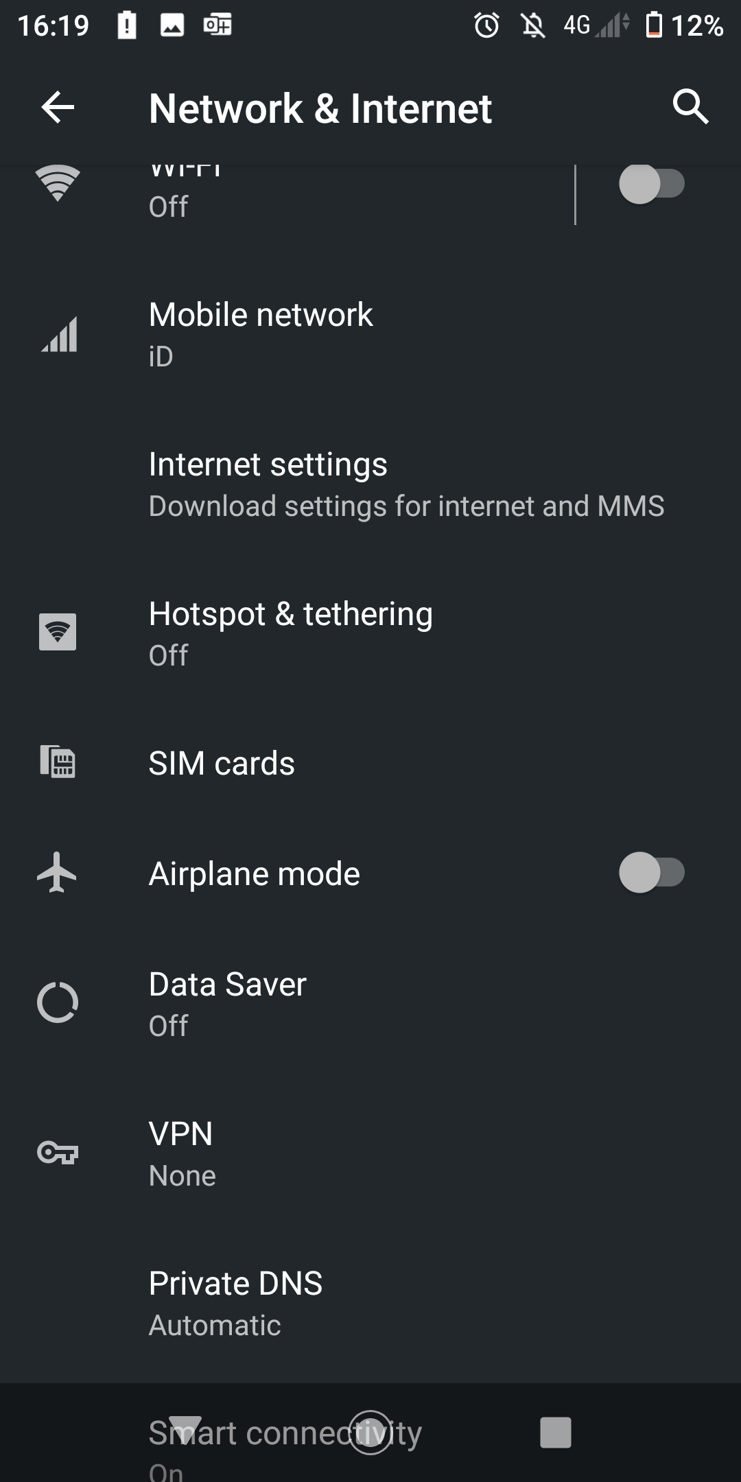

    Hi Anika
    I have posted a screenshot of my mobile network settings list
    And here's a screenshot of my network and Internet settings list.
    No mention of WiFi calling or volte
