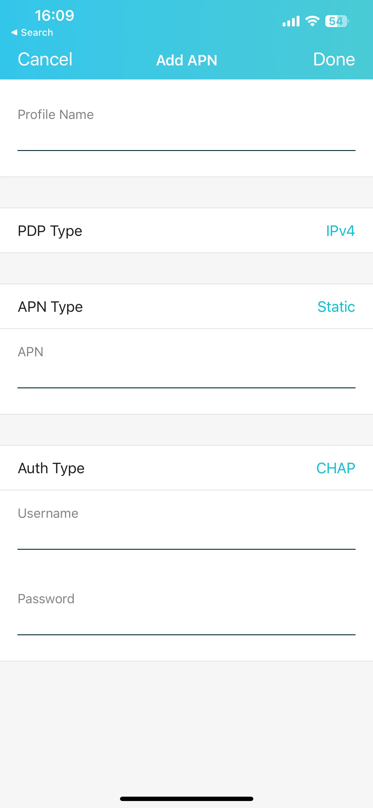

Thanks Mohamed this is the info we have got from iDmobile re APN settings - see attached screen shot. The other screenshot is the information our TP link mifi requires. Could you please advise what we should enter against each heading. We have had a few attempts in France but have had no luck.
We are going to be in France next Monday and really need this to work. Is there a possibility to liaise with you while we are there to do the settings with you?
many thanks
  • Community Member
  • February 23, 2023
Here is the TP link mifi requirements for APN settings
  • February 23, 2023
Okay @Hcgrant, I believe the only value you need to enter is “id” for APN.
Sometimes iD’s network roaming partners in France seem to ‘think’ iD SIM cards are Three UK SIM cards, and use the wrong APN value.

  • Community Member
  • February 27, 2023
So the answer is you need to be very precise!
Profile name: ID (capital letters need to be used)
APN: id (lower case letters need to be used)
Please ask iDmobile to make these instructions clear for anyone using a mifi!
many thanks
