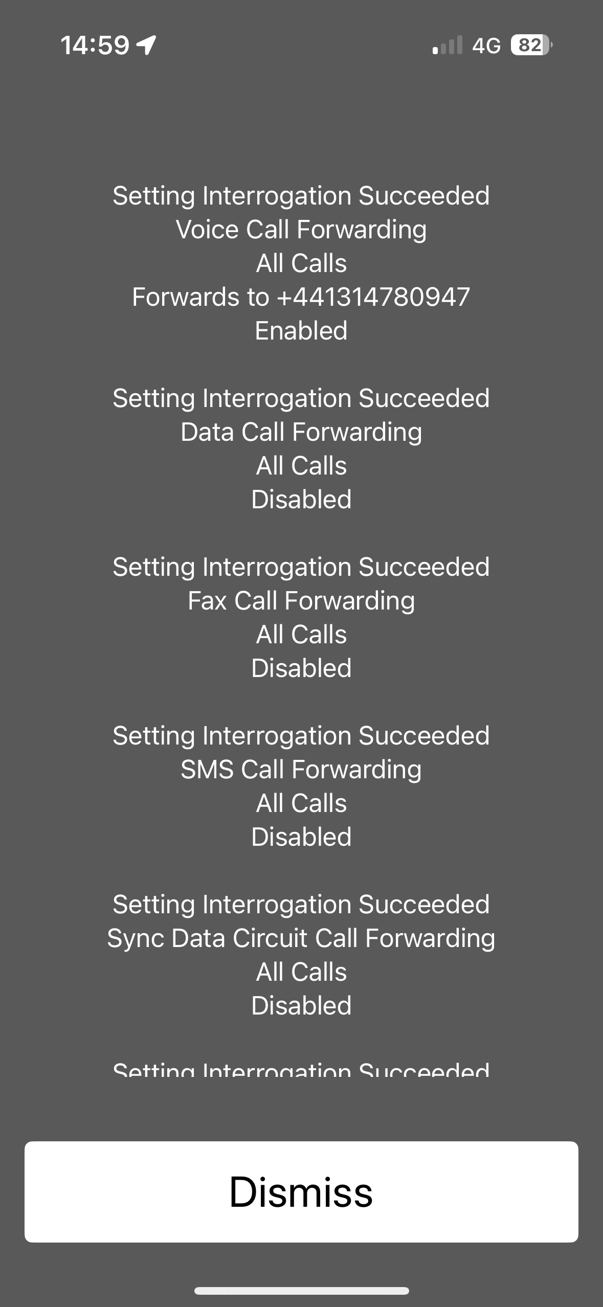

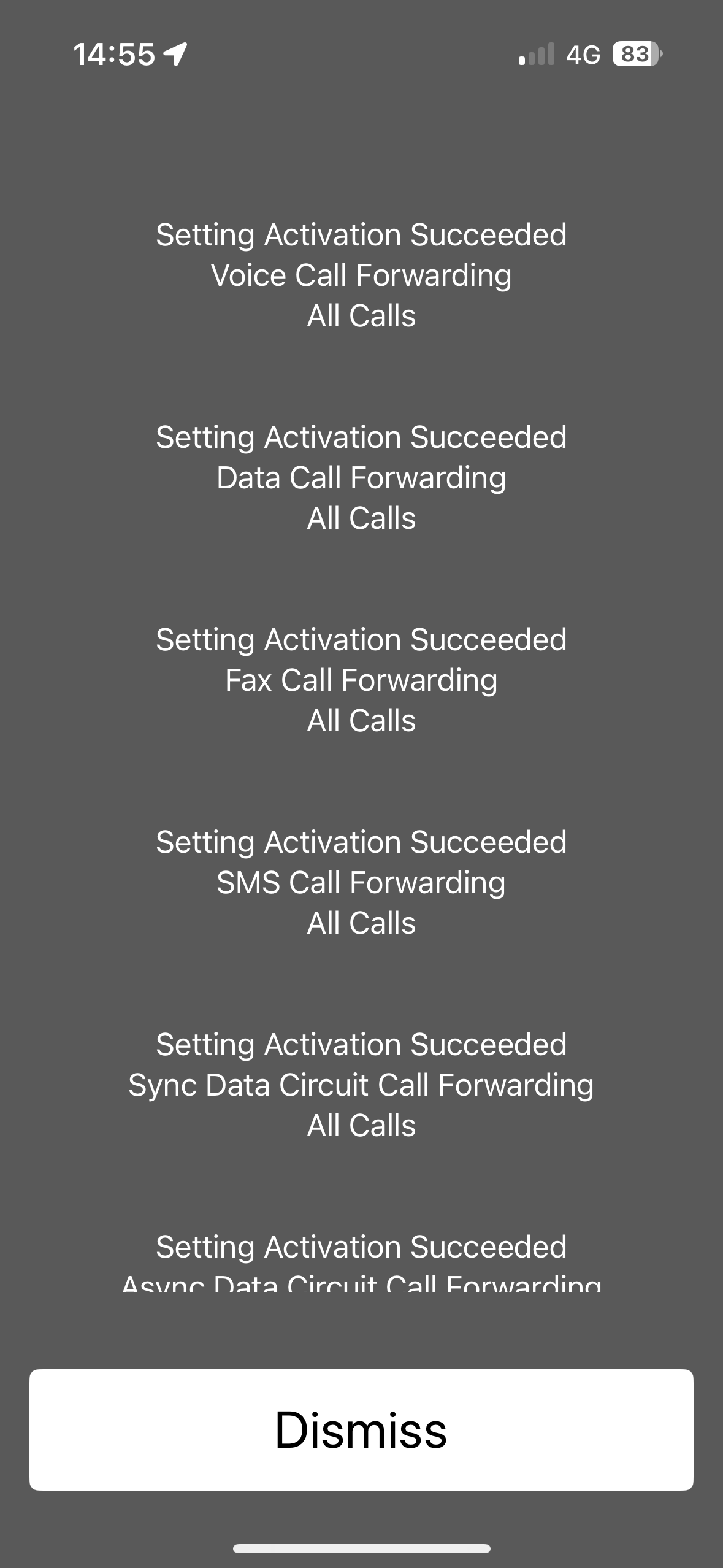

I used *002*number* to forward my phone to another number. According to the first screen below, it worked! So, I called my phone and it rang on the handset…. Not on the number I had forwarded it to.
I called *#002# to see what the carrier network said and got the second screen… showing it clearing thinks incoming calls are diverted. But they are not.
