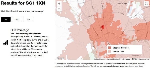

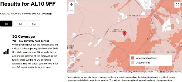

It was making calls just fine while in store?
Please could you let us know the postcode(s) where you’re having issues and the postcode of the store you were at when calls were okay?
  • November 9, 2024
Hi Tom. The Currys store postcode is SG1 1XN. My postcode is AL10 9FF. I just tried ringing my home phone and this time after a short wait it work although I noticed selected network iD not available did initally come up.

  • November 9, 2024
Hi @d.pedley
Taking a look the 3G coverage at the Currys store may be working still whereas the 3G coverage in your postcode looks to be weaker or disabled, this may be the cause of the issue.
Daz_S
  • November 9, 2024
Just spotted the reply with the postcodes provided.
And for you, the indoor 3G is poor
And, as I thought, Currys is good indoors
Which explains why it worked at Currys and not that well at your home.
