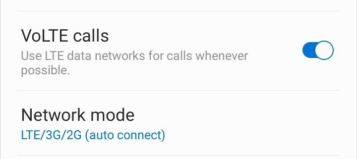

My wife has a Samsung Galaxy S7.  Under Network mode it says  "2G/3G/4G (auto connect)" but our present supplier (Smarty) says that after 3G switch off "even though your device has VoLTE capability, it won't work on SMARTY and some other providers due to a technical issue related to the timing of our VoLTE launch.”
Before switching to ID, I want to be sure that the same issue will not arise with ID when 3G is switched off.
The ID website lists the Galaxy S7 as compatible with its SIM only deals but it’s not clear whether this might change after 3G switch off.  The ID web site says: “If you have a 4G (VoLTE) Calling phone, but 4G is disabled within your phone settings, you’ll still be able to send texts and use your data, but you won’t be able to make calls.” but this still doesn’t resolve the issue.  I’m pretty sure the phone will work on 4G (as it seems to at present) but how do I find out if the VoLTE capability will be available with ID?  At present (with Smarty) there is no option to switch on VoLTE.  Will this option be activated if I switch to ID?

I’m not so sure.  Others say that you need  4G (VoLTE) not just 4G to be able to make and receive calls.  Our Samsung Galaxy S7 has 4G but does not have an option to turn on VoLTE.

Unless you SG handset states LTE under the Network mode then you won’t have the capability to use the VoLTE network.

If you don’t see LTE then you not be able make/receive calls after the SMARTY 3G network is switched off.
I was on SMARTY previously with my SG J4+ and it was unsupported by them and I coudn’t make/receive calls when the 3G network was turned off (I thought that this was the problem). So I moved over to iD Mobile, because they did support my handset, and yet I still had the same problem and this was because I didn’t have the LTE option in my network mode. So unless you see LTE it won’t work over VoLTE (With ANY provider excpet the one that controls the software).

In the end we decided to upgrade to a (second hand) S23.  It was notable that even this had problems with phone calls until the VoLTE setting was turned on.
