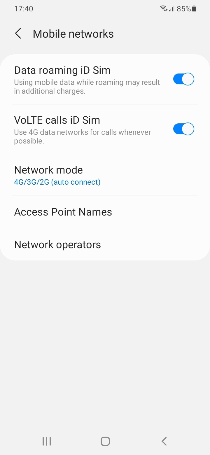

This is how it's set up and the phone is a Samsung Galaxy A20e.

That looks good to me.
So, a few things you could try:
  1. If you have a Samsung account (or create one if so wish) → go to the Galaxy Store app→ MenuUpdates and see if any are showing. You’d be surprised how many of these phones have updates waiting for them
  2. From any screen, if you swipe down and turn off the Wi-Fi. Does 4G show immediately in place of the Wi-Fi icon? It should.
  3. From that screenshot you posted, click on Network operators → slide Select automatically to off → it’ll auto scan for all available networks and then select any of the other networks BUT NOT iD. It’ll try to connect and fail (you want this to happen). Then from that same screen select iD. It’ll reconnect and I would suggest you slide auto back on → at this point you might see it’s connects to iD again and that’s perfectly fine if it does or doesn’t. Close that page.
  4. With the WiFi still off can you make a call now?
  5. If you still can’t make a call turn the WiFi back on press the green call button, at the top you should see 3 dots, tap this and click on settings. Look for Wi-Fi calling and if it’s off swipe it on. Can you now make a call (this will be a Wi-Fi call not a ‘normal’ call?
  6. If Wi-Fi calling was already on and you could make a call, try with it turned off. Can you make a call now?
Just a note about #3. This should reset the iD network without losing all of your saved Wi-Fi passwords etc. This is something I’ve suggested to others many times and have done so myself a few times now since joining iD - I too am having issues but mines only poor signal, not the lack making or receiving calls.
If you can only make calls over Wi-Fi then either I’ve missed something, or something is set wrong with your phone, the network in your area is throwing a wobbly or something isn’t configured right with iD.
It may even be the case that the account isn’t going fully live until (whats now later on) today.

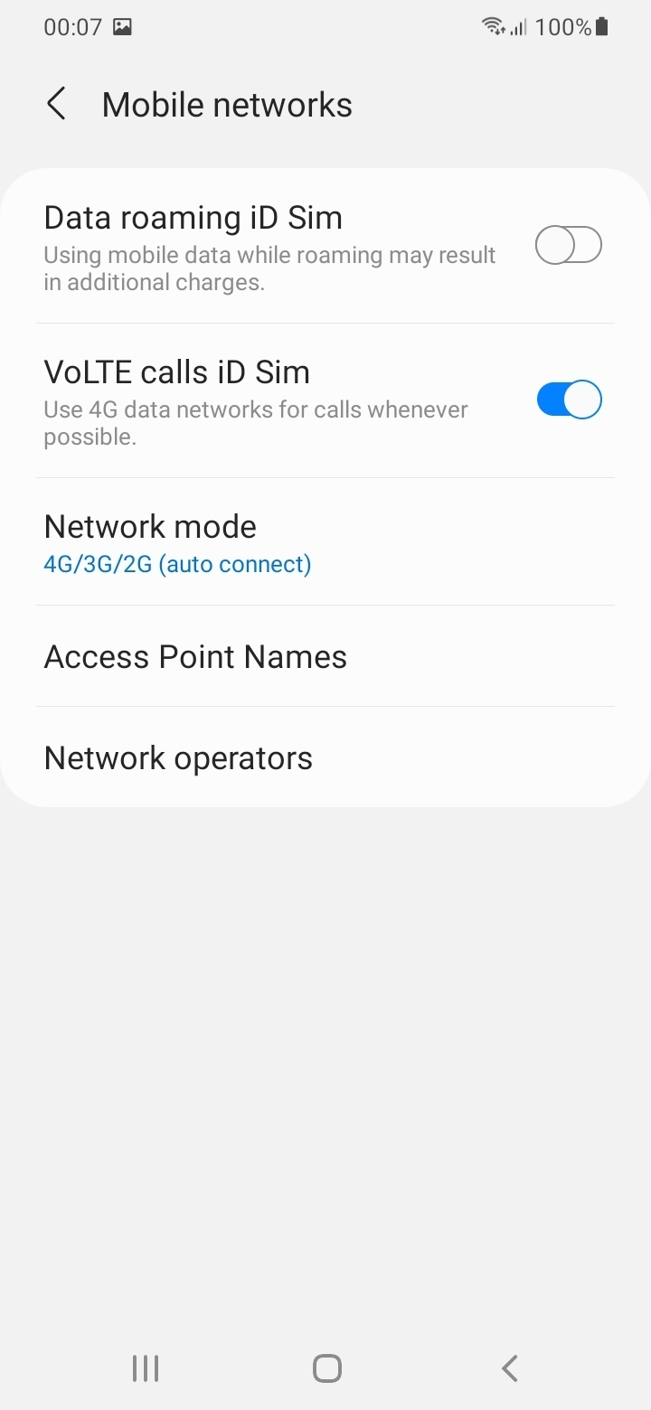

It's a samsung galaxy A20e and yes I'm still not able to receive or make calls. This is how it is set up.
Decembersangel72
Silver Contributor
Hi @waynejohnson
Even though you have ‘VoLTE calls iD SIM’ turned on it looks as though you don’t have ‘LTE’ enabled in the ‘Network Mode’.
On a SG phone you need to see ‘LTE’ in the Network mode (Settings > Connections > Mobile Networks > Network Mode > LTE/3G/2G (auto connect)) for it to actually be able to connect (even if the VoLTE calls toggle is on).
‘4G’ is just a label for the ‘4th Generation’ network connection but VoLTE (Voice over LTE) is the actual type of network and so you need to connect to ‘LTE’ to be able to use it.
‘Google’ (other search engines are available) is your friend on how to do this if it is not available in your phones settings.

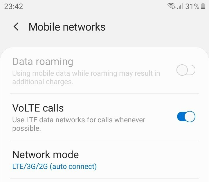

This is my SG phone…..

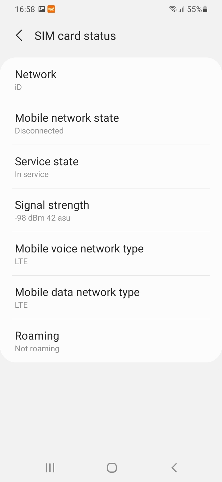

I’m happy to be corrected, but the screen Wayne posted still looks ok to me, albeit the latter screen shows Roaming on, that should really be off unless using the phone overseas. My wife’s phone is newer than mine and I’m sure hers is also like Wayne’s - I can check that later as I don’t have access to that phone at time of posting this.
But there is somewhere else to check and verify if LTE is enabled for voice calls and that’s to go:
Settings → (then scroll down to) About phoneStatus informationSIM card status → and under Mobile voice network type does it show LTE and does Mobile data network show as LTE (or again maybe as yours is a newer phone) 4G?
FWIW mine both state LTE, however during an actually call (and possibly due to my ongoing signal issues) each one drops to UMTS and HSPA+ respectively
  • 11 replies
  • November 4, 2024
This is what it says on Sim card status page.
Def got to be with some set up on my phone as wife has same phone and if I put my sim in hers it works.

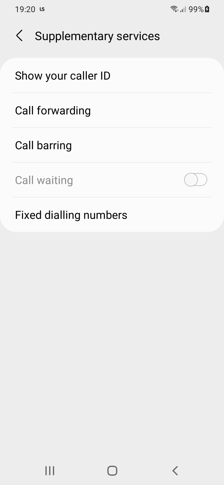

Not sure if this is anything but when I try and go in to this it's says failed to connect.
On wife's phone under show your caller ID it says Network default but on my phone nothing.
  • 11 replies
  • November 4, 2024
No none of them worked.
Not sure if this is anything. But on wife's phone under show caller ID it says Network default.
On my phone it says failed to read data when I try to click on anything.

<Hoping this posts as it’s taken sometime to get passed an iD splash screen stating something’s gone wrong - seeing this on a few different threads too>
Doh! @waynejohnson I’m struggling to think of what else it can be.
Maybe either a replacement SIM(s) or maybe even giving an eSIM a try.
I’ve checked mine (green phone button → settings → Supplementary services) and mine’s like your wife’s. On Show your caller ID mine also states Network default - when clicked on I see that option, plus Never and Always.
I think the fact neither showing your current (or any number) under the about phone could be where this issue starts, BUT that doesn’t explain why your SIM works in your wife’s phone.
